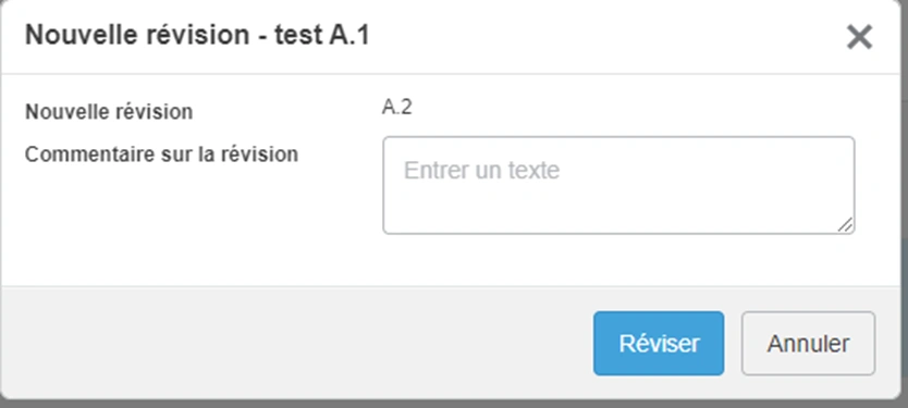

Hello,
When I enable the "main and secondary" revision format in collaborative spaces configuration center, the automatic revision naming behaves well for newly created content.
For non-distributed content, the format used is .#. Which is fine.

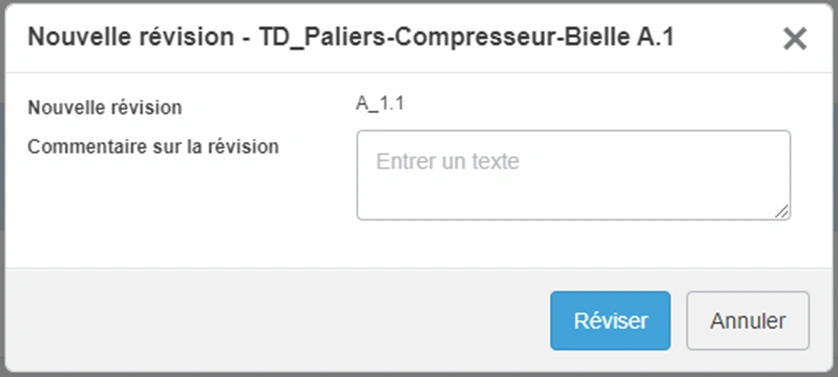

However, for old platform content, the automatically created revision format corresponds to a "Main and secondary for 3DExperience content with Solidworks Master" revision format (with the _ character): _#.
The behavior occurs when creating a new revision and also when duplicating on already content.
I would like the behavior to be the same for already existing content, i.e. with the .# format
Is there a setting to be made or is this bad behavior and if so, could you correct it?
