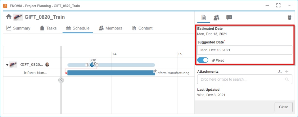

Question: Is it possible to deactivate the exact "time-relevance" for Tasks and Milestones or to modify the default time used for these objects?

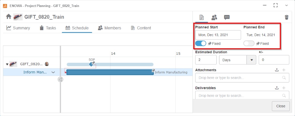

Problem description: When adding a Milestone or a Task, you can only define a date and no time, using the "Properties" menu. So a Milestone is automatically set roughly 5 pm by default and a Task normally starts at roughly 6:30 am by default. When now creating a Task, that should start the same day as the Milestone but should also be related to the Milestone (depends on), there is a time-overlap leading to a red arrow. While not having options to enter an exact time by "Properties", the only way to solve this problem is to zoom in to a view, that also displays time-grid and modify the Milestone roughly by hand and place it before start of the Task.​​​​​​​
Side effect: When deactivating the "Fixed" constraint of the Task to be driven by the the relation to the Milestone, the Task automatically starts on the next day (seems to be that 5 pm we do not start working anymore > Feierabend...)
