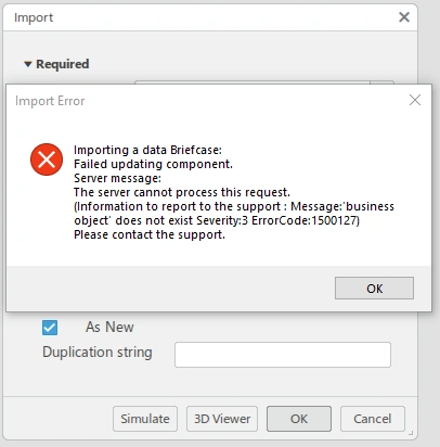

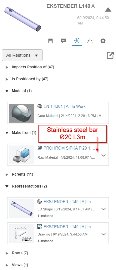

Hello, I am having trouble to import 3Dxml part from customer cloud tenant (latest HF) when raw material is applied to part from Specification manager role (see picture). Export is done without problem with 3Dxml with authoring option + with all representations.
When I tried to import on another tenant I got this message from platform: ‘Business object’ does not exist Severity:3 Error code:1500127.
Any suggestion? Is there some special settings for export/import on platform level?

Picture from original file (relations) Error message during import
