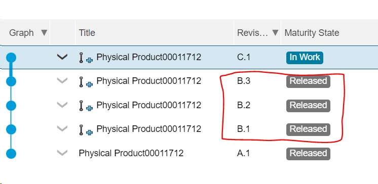

Primary and Secondary revision won´t prevent me from releasing multiple secondary revisions of same primary
Hello,
