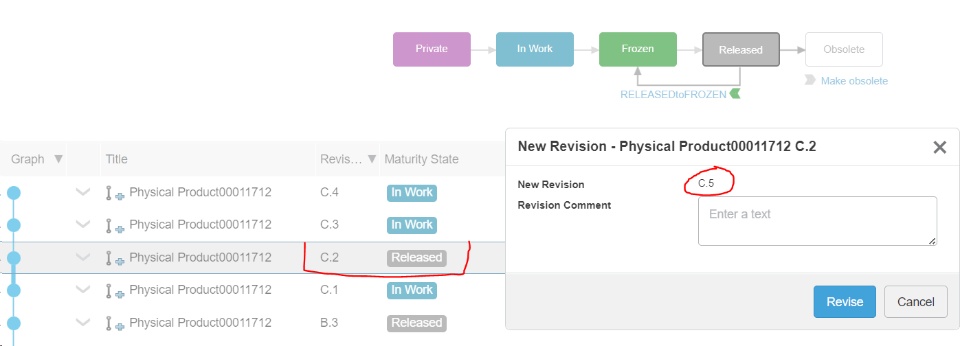

Primary and Secondary revision, new primary value not created when i have released not the last previous revision
Hello,
When i have multiple C revisions (from 1 to 4) i would want to released C.2 because this design would be best after comprehensive testing (use case scenario). But when i do and want to create a new revision, system creates C.5 revision not D.1 revision. Only way which i know to get system to create D.1 revision is to either:
  • remove C.3 and C.4 (want to keep these design states for future references)
  • release C.4 or, create new revision C.5 which would hold design of C.2 and release that
Is this behavior correct? Can i change it via admin settings? Thanks in advance.
