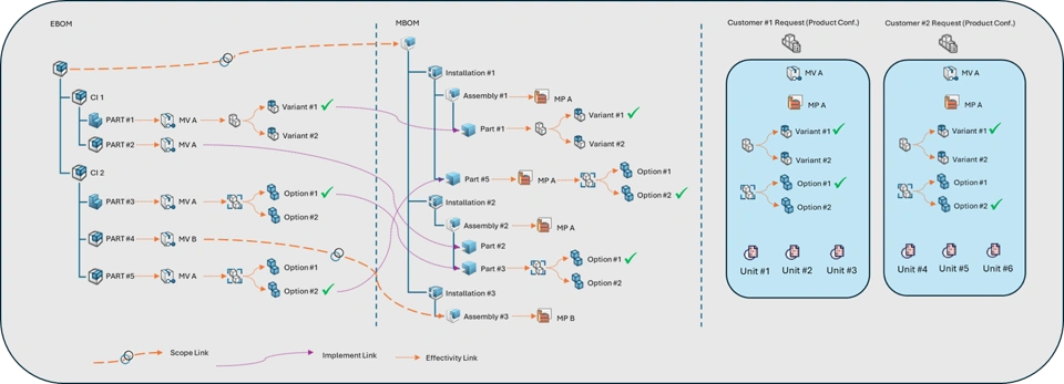

I work in an aerospace company, and I have created the following hypothetical situation that is similar to our current scenario. (shown in the figure above).
Following the relationships established in the figure above, if I filter the EBOM and the MBOM for a Customer Request - using the Product Configuration Object -, then only the following parts should appear (100% BOM):
For Customer #1: For EBOM (Part #1, Part #2, Part #3), While for MBOM (Assembly #1, Part#1, Assembly #2, Part #2, Part #3).
For Customer #2: For EBOM (Part #1, Part #2, Part #5), While for MBOM (Assembly #1, Part#1, Assembly #2, Part #2, Part #5).
My questions are the following:
Given that I have been able to prepare the data as shown in the figure,
Q1: What is the best practice to prepare the data to be sent to ERP for customer 1 and 2?
Q2: What would be the top node collecting the BOM that will run the MRP for each unit? And what is the best practice to set it up?
