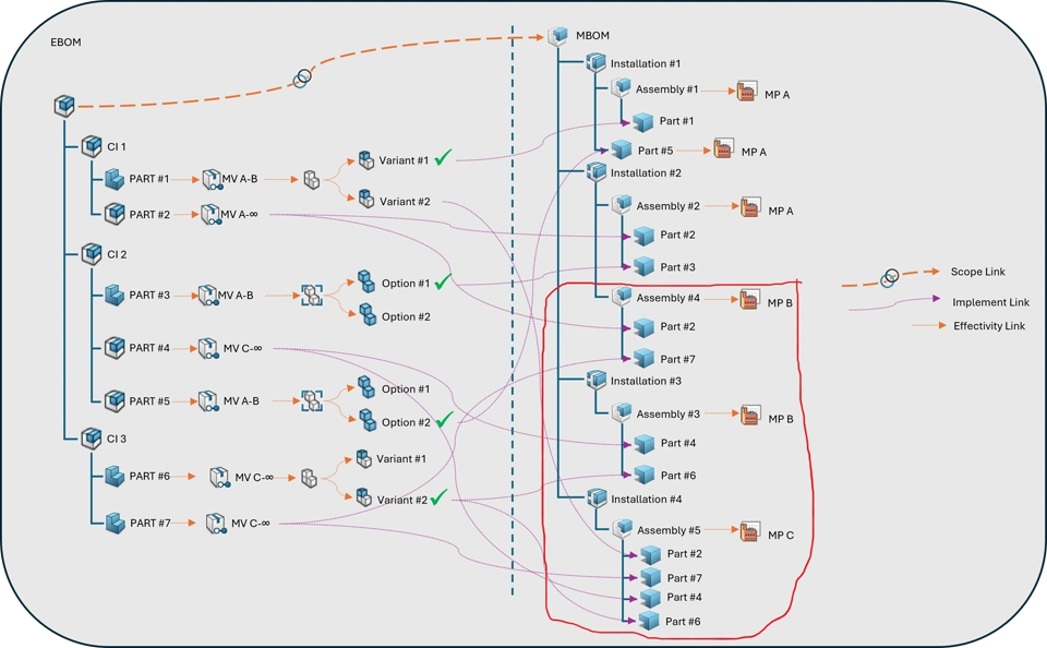

I have created the hypothetical data set below:
                                                                                 Figure1: Data Model

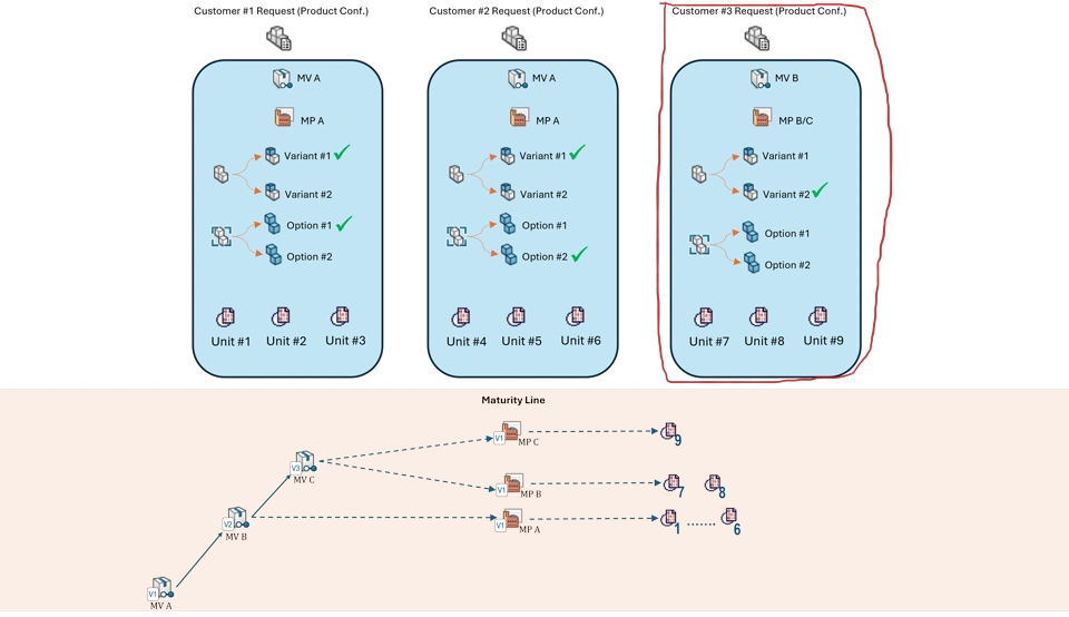

                                        Figure 2: Customer requests and the relationship between MVs, MPs, and units
  1. Objective:
    To send to ERP the filtered (100%) MBOMs for Customer #3 ((Unit #7, Unit #8 = MP B), (Unit #9 = MP C)).

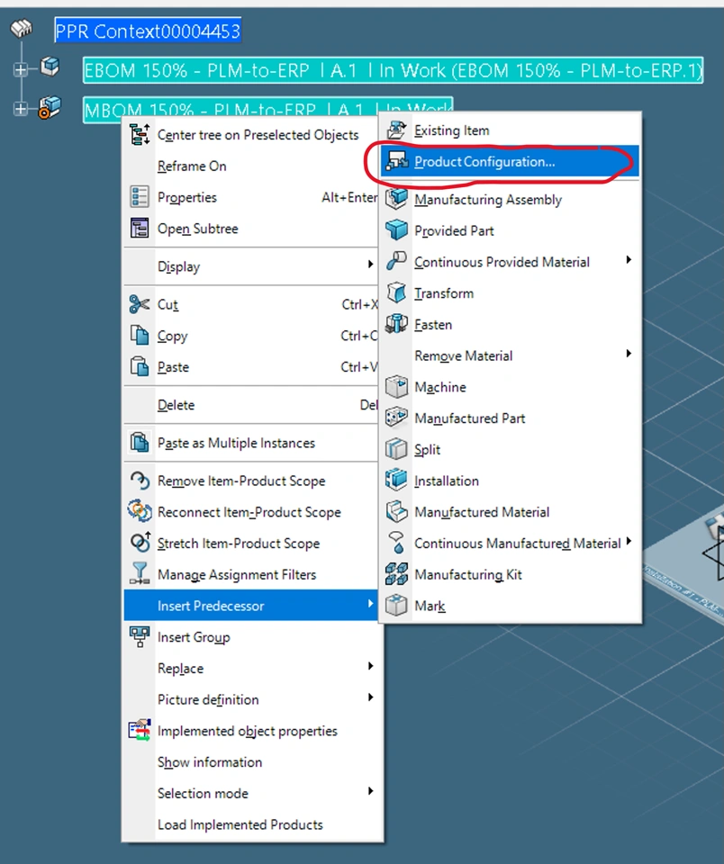

    1. Method No.1: Using Insert Product Configuration
      In this method, a new root node is created under the PPR, then we select the option “Insert Predecessor”, then “Product Configuration”, as can be seen in the figure below:
                                                                                        Figure 3: Insert Product Configuration
However, the issue with this method is that it allows you to filter the “Product Configuration” by Model Version, but referring back to “Figure 2”, Customer #3 has 2 Manufacturing Plans (MP B, and MP C), so filtering by product configuration does not yield a 100% MBOM, but rather an MBOM with both MP B and MP C, which shows (Assembly #3, Assembly #4, and Assembly #5) (refer to Figure 1).
