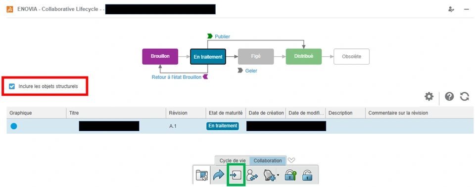

Do you know how to move an element and its structural objects from one organization to another at the same time?
To do this, I use the “Move” (command framed in green). However, I'm running into some issues:
On Collaborative Lifecycle:
The “Include Structural Objects” checkbox exists (checkbox framed in red). However, when I actually perform the move, only the object visible in the Collaborative Lifecycle changes organizations. The 3DShape, drawing, or other child elements are not moved even though the checkbox is selected.
Question: Do you have a solution for moving everything at the same time?
