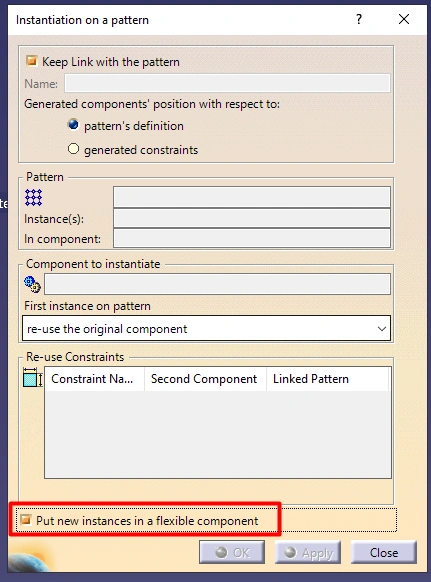

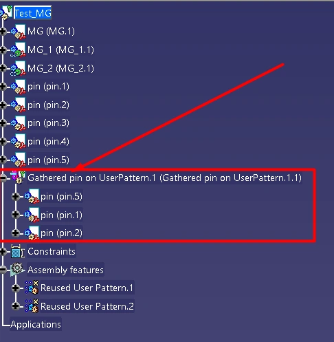

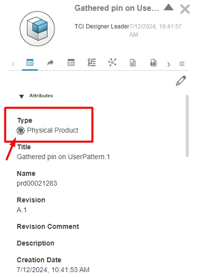

While duplicating with the reuse pattern in CATIA V5, I select the "Put new instances in a flexible component" option shown in picture 1. After this selection, Gathered objects are created in the product tree as shown in Picture 2 and the instances are placed under this product. However, this product type appears as an embedded component in the 3DExperience Power By integration. We are having trouble releasing or deleting the product.The release problem experienced is shown in pictures 3 and 4.
What solutions does 3DExperience offer for parts with embedded components? How should we manage this data?
As a current solution, I recreate the Reuse pattern without selecting the "Put new instances in flexible component" box and continue this process.
Is there a short way to do this?
