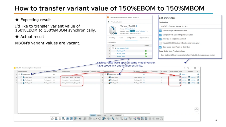

- How to transfer variant value of 150%EBOM to 150%MBOM synchronically?
I'd like to make same setting; EBOM product and MBOM item linked by implement links, at first.
Senario
1) Define model version and variant value as shown by attached file.
2) EBOM's objects is applied the configuration (model version and variant values).
3) Make MBOM's top with the scope link to EBOM's top and model version setting.
4) Do the command of "Create Mfg Items Structure", make MBOM's Items with implement links.
5) Variant values are vacant.
If I do the command of "Synchronize Variant” command" on native app, errors occur.
