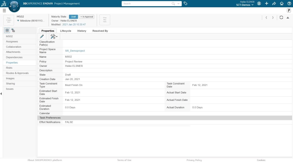

Scenario:
Milestone MS02 has constraint date "Must finish on".
Task 215 has a dependency on MS02 with FS +0 d and the end date is before Milestone MS02.
Now the End Date of Task 215 changes to a date after the milestone and creates a conflict. But the change is still applied, with no indication of it, either in color or as a message.
