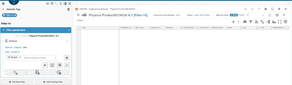

Problem is, when you set in filter to "remove" type 3DShape, it also takes physical products within.

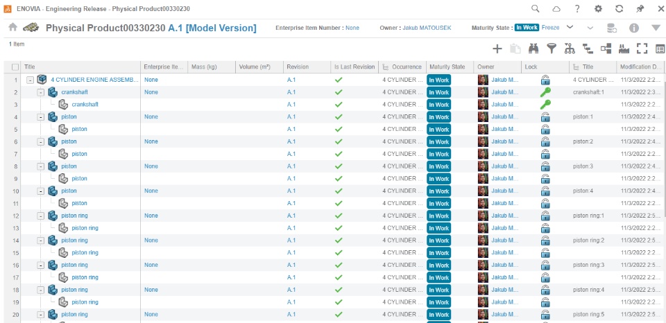

Without filter or 6WTags​​​​​​​

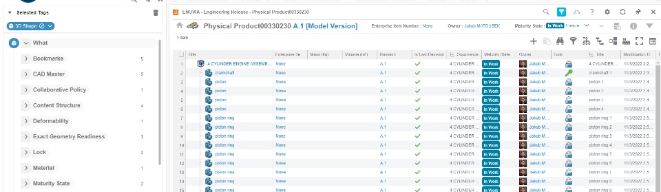

With 6WTag (exclude type 3Dshape
With filter (remove>type>equal to>3DShape)
