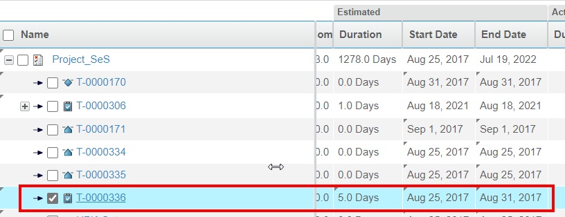

I have a question about the allocation management in DPM license:
How can I handle following Use Case? Effort allocation to several days should increase if allocation is at e.g. 50%. Person A needs 5 days for the task, but can only deliver 50% per day, which means that the person needs 10 days at 50% allocation for the same effort. How can I handle this use case for the estimated Duration? If I want to change the Start and End date to 10 days the effort will be automatically calculated to 80hours and not 40hours at 50% allocation.
