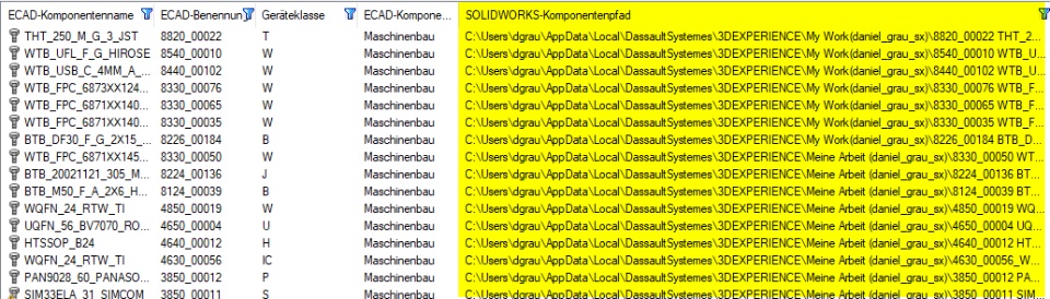

Depending on the language of the PLM the parts in Circuit works gets different Paths (see Pictures)
Moreover the created paths contains my username.
So I assume the created components wont be found in CurcuitWorks for other users.
Even if I delete the parts in my local cache the CircuitWorks doesnt load the files out of the PLM and so the Parts wont be opened.
Does anyone has a solution to work successfully with CircuitWorks, Enovia PLM, and multiple users?
