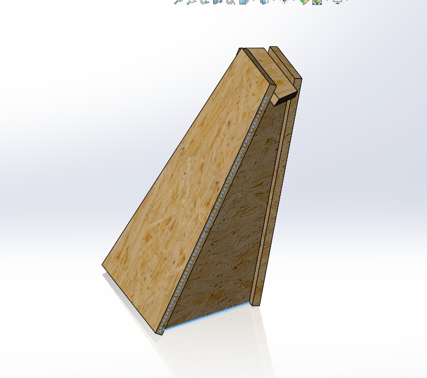

Dear community,
I need some help with creating a drawing view that is normal to a plane, that is rotated in two dimensions. If it would have been in 1 dimension I could have used Auxiliary view, but I can't use two auxiliary views on top of each other.
The part is the side panel of a single part, and it was deduced from a single body and then split into multiple bodies.
Perhaps I could try to export the body into a new part, or assembly and rotate it, but wouldnt there be a much more simple solution? In the 3D model it is dead easy to get the view on screen, but I've been fiddling around with it for an hour in the drawing sheet.
