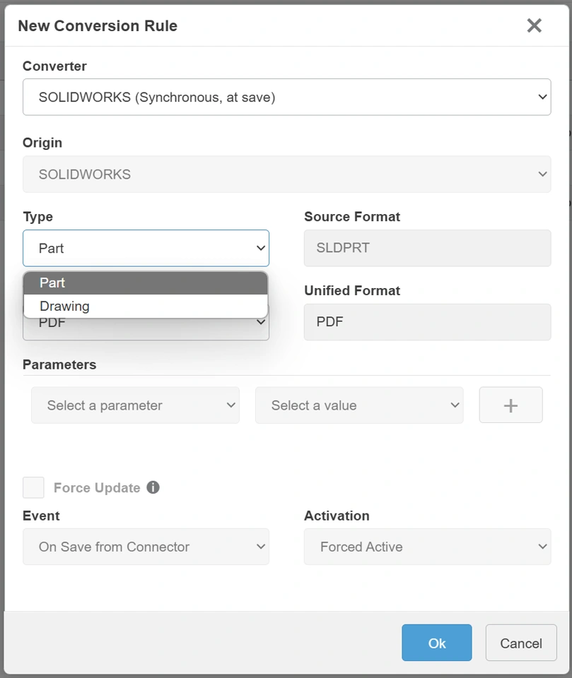

Using 3DExperience Cloud, when creating derived format conversion rules for SOLIDWORKS, we have options for parts and drawings, but no options for assemblies, as shown in the image below.
This is a critical issue because other 3DX users cannot download STEP files of assemblies, so they must have a SW + Connector license to open SW assemblies and convert them to STEP.
Any workaround for this? At our company, it is rather important for our supplier development and CAE team to be able to download step files from 3DX.
