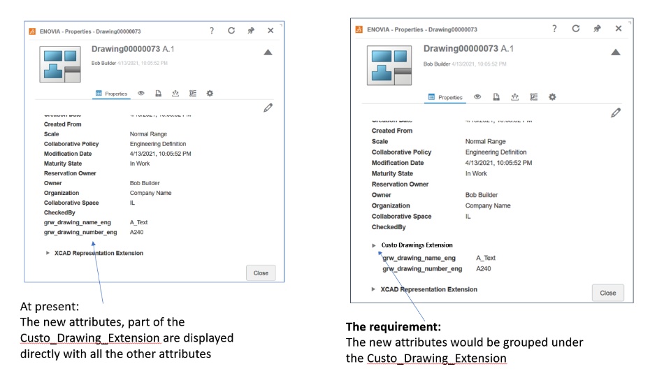

I have created a new extension with attributes to Drawing type using the Data Model Customization app.
The new extension name is Custo_Drawings_Extension and 2 new attributes were created for this extension.
The new attributes are visible in the information panel of Drawing object but they look like any other attribute added to this type of object.
Is it possible to have these extension attributes grouped as an extension, with a collapsible button, similar, for example, to the mcad representation extension?
How can I set the order in which the new attributes are displayed?
