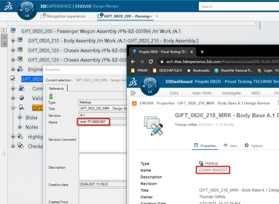

cross-compatibility of native client mark-up and web client mark-up
When creating a mark-up inside a native client review, this mark-up is named by "mrk-...", while when creating a mark-up inside the web client, this mark-up is named "DGMK-...". While web client mark-ups can be linked inside the bookmark structure, native client mark-ups can not be stored or even be found or viewed inside the web client. Also mark-ups, created in web client can not be opened inside the native client.
Will there be an alignment and interchangeability for these two mark-up types in future?
