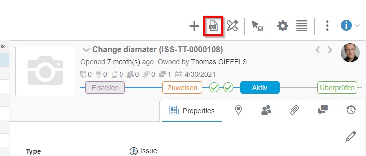

First of all, the new widget based Change Governance is really a great simplification for using Change Request and Change Order for casual and also expert 3DEXP User!
But what I'm missing right now is a streamlined relation workflow to the Issue Management. In my understanding, an Issue is always seen as an appropriate tool for launching a Change demand (as seen on some DS presentations). While a Change Action can be established directly out of an Issue, I'm missing the same option for a Change Request, that is (in my opinion) also a consistent result for an Issue assessment.Today, the CR must be created manually and the Issue must be allocated also manually to this CR (so the option is available to link these two objects).
Question now: will there be an CR-creation-option available too for the Issue Management in future (just missing on GA)? Or what is the strategic reason, this will not be available (maybe I do not understand the correlations in the right way)?
