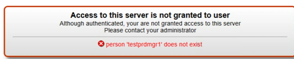

We have newly installed 3DX 2021x on Windows embedded TOMEE option.
Using admin_platform able to login successfully but newly created TEST users unable login CAS Server.NO CAS server able to login successfully.
This issue happening only CAS server.
UserName:TestPrdMgr1
3DSpace and 3dpassport created same case.
We have created user using VPLMPOSImport.bat script
During Passport Installation we have selected below option
Force Lower Case: Checked
getting below issue
Please advise us any one have idea related this issue.
