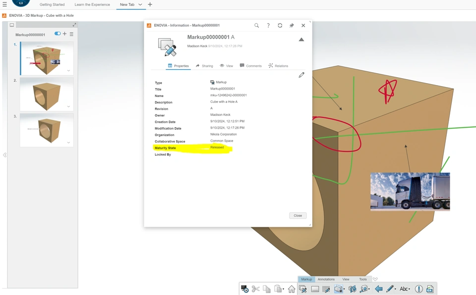

Hello, I am investigating the usage of 3D Markup and the embedded compare tool to document what changes are made to a given part and attach the markup to a relavant CA. However when I release my markup, I am still allowed to make changes to the annotations. How can I completely release the Markup object to no longer allow any EDITING? I still want to be able to spin the CAD and view the slides/annotations, but I should not be able too made changes to the slides.
In this screenshot, I added the GREEN freehand drawing marks AFTER the markup was released as well as the second slide. I would expect this to have an error message because the data should no longer be able to be edited.
