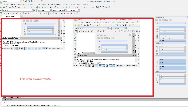

- I draw square at draw area, then when I crick at the end point of making square, screen freeze.
- I made new project. (No problem)
- I made poly-line (finally no problem, 1 quit 6 paths)
- to select poly-line, I move mouse cursor, then screen freeze.
Issue RefreshAll command, then nothing are changed at all (still screen freeze)
- Under both trial, Draftsight works well except drawing window, even printing. (customer drawing can print properly, only I can't see on screen)
- freeze screen is only drawing area, other console, property window, menu, and others are fine.
Only I can't modify and see any drawing on screen.
- When mouse moving, coordinate is updating on status bar, when wheel rolling, property windows is updating.
When I execute blind operation (issue draw command on console), after print drawing, every command executes normally, only screen never change.
- My OS is Windows 10 x64 latest updated.
PC is Lenovo X240, Core-i7-4600U@2.1GHz, IntelHD graphics 4400, DirectX 12.0 OpenGL 4.3, Memory 8GB.
Attached snapshot is after draw square, screen freeze, and after I close window and open window.
