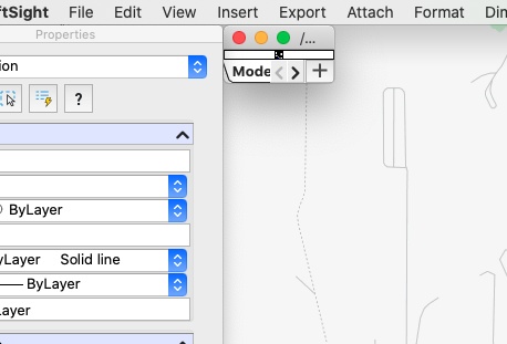

Double-clicking a DWG while DraftSight isn’t already running will start DraftSight and open the file, but in a tiny window that then has to be resized. A minor annoyance.
