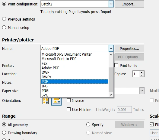

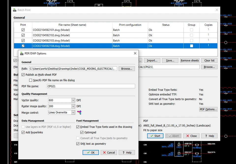

I'm using Draftsight 2023.I wanted to print several drawings into a single PDF file, I used to be able to do this but for some reason it wouldn't give me the option to "Publish as Multi-sheet PDF". Also note that the PDF options is grayed out.

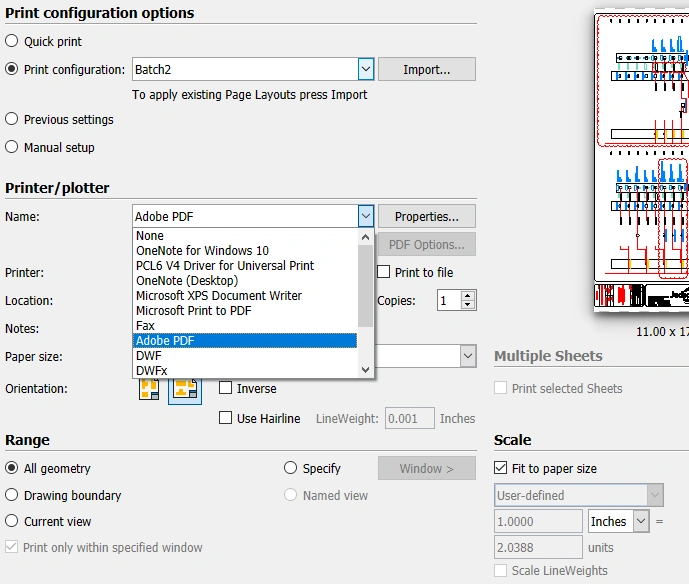

I created a Batch configuration file and tried using both "Microsoft print to PDF" and Adobe PDF as the printer and neither PDF printers worked.
What solved the issue is when I finally scrolled down and found the "PDF" as the printer name.
Anyway, this solved the issue and I hope to save someone else the frustration.
