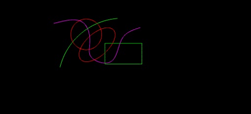

I use various layers with line colors associated to them in DraftSight,

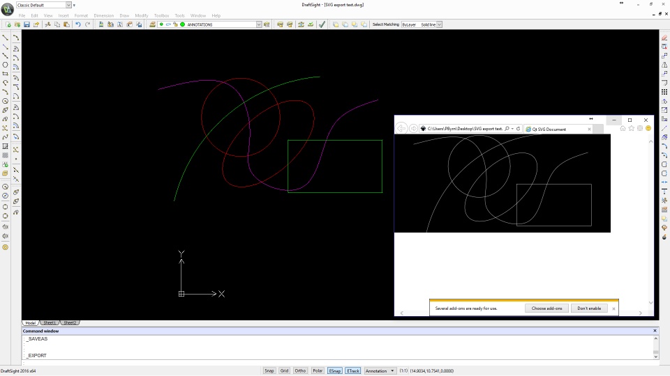

In previous versions of DraftSight, the exported SVG file would retain this layer information - line colors would stay the same, and the elements in the same layer would remain grouped together.
But as of DS 2016 x64 SP2, an exported SVG file now turns all element line colors to white, and the elements no longer remain grouped together accurately by layer. This would require a lot of subsequent cleanup work after the file is exported.
It would really mean a lot to me to have the layer associations restored for the SVG export in DraftSight. Is this perhaps a bug or is there a setting I could toggle?
