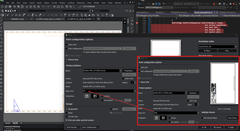

We have external tools that take the dwg file and convert each sheet into pdf's. We have problems, with some files that have set the wrong printing area. See below. There is extra space at the top. This is because the letter is set as paper size.

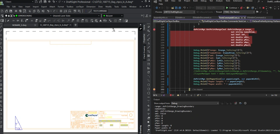

I tried to follow this example:
https://help.solidworks.com/2019/english/api/draftsightapi/HelpViewerDS.aspx?version=2019&prod=api&lang=english&path=draftsightapi%2fGet_and_Set_Print_Options_Example_CSharp.htm
But paper size is set when I choose a printer and even if I use e.g. "dsPrintMgr.PaperSize = "A4"" it isn't saved in the sheet/printing settings.
I think I'm looking at the wrong place. But I checked e.g. ISheet Interface and there is nothing about the paper size. The same IDocument Interface.
