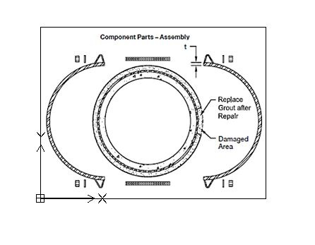

When the image is first inserted, it displays correctly:

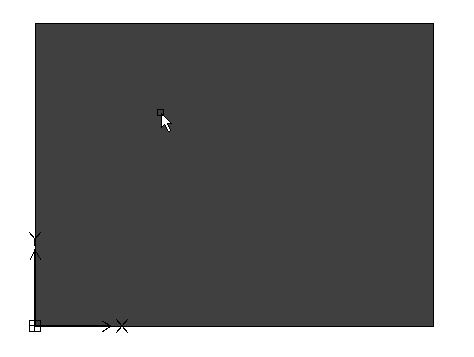

As soon as I pan, zoom or draw any new geometry the image becomes a grey rectangle:
I can get the image to display correctly by selecting it, changing the "Show Image" property to "No" and then changing it back to "Yes" again.  However, as before, when any change are made to the drawing the reference image changes back to the gray rectangle.
