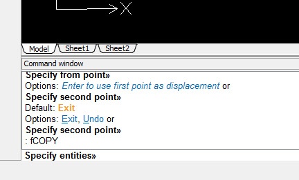

I've run into an issue that I believe to be a bug, but could be an option in Draftsight that I don't understand yet. The issue is that when I enter a command in the command line, DraftSight will occasionally start the previous command but add the command I am trying to use as a prefix. I know it sounds a little strange. For example, if I try and initiate the "copy" command by entering "c" into the command line, but the previous command was "move", sometimes Draftsight will initiate the move command, and the command line will read "cMOVE" and the move command will be active. This doesn't happen all the time, only occasionally.
I've attached a screenshot of the command line for reference. in this example, I had originally initiated the "copy" command. After I had finished copying something, I then initiated the "fillet" command. As you can see in the command line, it reads "fCOPY" and the copy command was active, not the fillet command.
Is this a bug or a feature that I just don't know yet?
