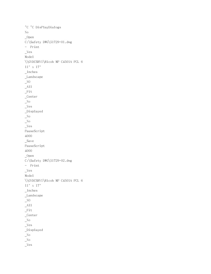

Hi I'm tiring to print multiple drawings out of a file directory and have written a scrip to find, open, print then close the drawing before opening the next drawing the problem I'm having after the first drawing is opened it never closes and keeps being sent to the printer although all the remaining drawings  show they had opened I have also tried using the save command with the same results. Is there a draft sight product to send a file full of drawing to a printer or a different command to use for closing a drawing with out the dialog box to answer if you need to save the drawing before opening the next and clearing the print buffer before opening the next drawing?
Thanks Larry
