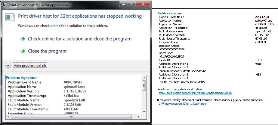

Print Driver host for 32bit applications has stopped working
Cannot Plot to Printer using DraftSight - Please assist
Printer works for all applications except DraftSight. Currently using DraftSightV1R2.1.
When I press the print button, I receive the message: "Print Driver host for 32bit applications has stopped working"
After clicking "Close the Program" in the error message, I receive the message "Current layout's paper size is not supported by the plotter configuration." followed by the normal plotter window. The plotter window operates correctly but nothing happens when I try to print.
Printing to PDF does work.
Working on Windows 7 64 bit using HP laser printer.
Rebooting the computer did not fix the issue.
