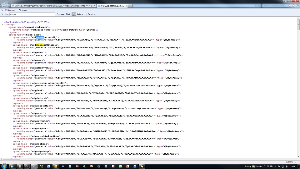

I'm facing a problem with the button mapping in DrafSight with my 3Dconnexion SpaceMouse Pro device. I posted the below posted message on the forum of 3Dconnexion to ask for help. I got as reply that DraftSight is directly communicating to the 3D-mouse and I should ask my question here at the DraftSight community.
Can anyone tell me how to solve this issue as described below? Any help is very welcome!
Mark
Hi all,
At my work I use DraftSight to work with older drawings. In my believe there is no supported driver included in the installation package of 3DxWare but as this was always working I assume Dassault Systems included some kind of driver themselves in DraftSight. In the past I used my personal SpaceNavigator and had assigned functions manually to the two buttons via the button mapping option in the menu. Now the company has given me a brand new SpaceMouse Pro to work with. When I tried to assign functions to the buttons I fased the problem that in some way it still reffers to my SN and gives me the option to assign LEFT or RIGHT button. But as soon as I hit a function it turns into blank.
First I checked the driver status. I was still on version 3.16.3 so I updated to the newest driver to see if that could bring improvement; it didn't. Then, with our IT-guy I went into the profiles folder. We first deleted this location completely to see if a fresh profile will improve the button mapping. It sadly didn't work so we went deeper and searched inside the .XML files to something referring to a 3D-controller. We found the one on the added picture.
We deleted the lines referring to the 3D-mouse. But that didn't work as well.Has anybody an idea how to reset the button mapping in order to assign more buttons to my SMP?
