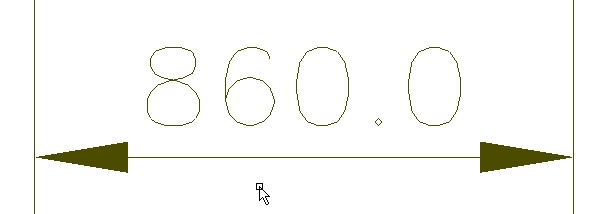

My dimensions are on a layer of their own with the color set to No. 56 (RGB 127,127,0) Here is a screen shot of part of the Model space:

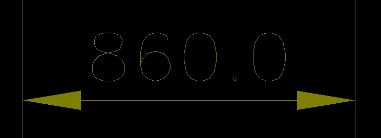

And here is the same part of the drawing in Sheet space:
Using a color picking app (gColor2) I can confirm that the Model space color is indeed 127,127,0
But the Sheet space color is 76,76,0 which is DraftSight color reference number 58.
If I choose a basic red color for dimensions then they appear as pure red (255,0,0) in both the model and sheet spaces.
What is going on?
