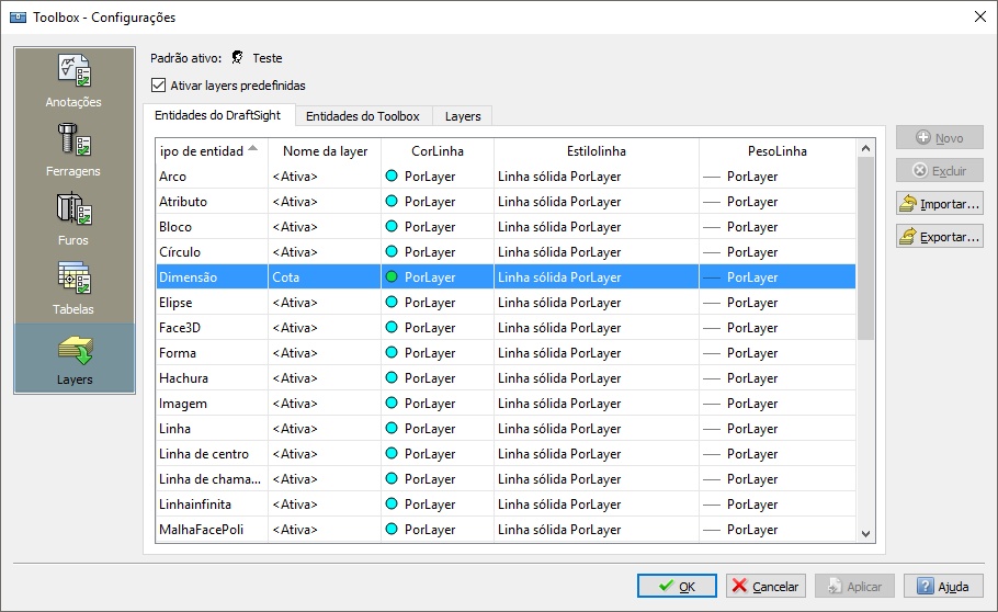

On Toolbox Settings, Layers, I set Centerline Layer Name to a custom layer (named Centro, Color RED, LineStyle Dashdot) and LineColor, LineStyle and LineWeight all to ByLayer.

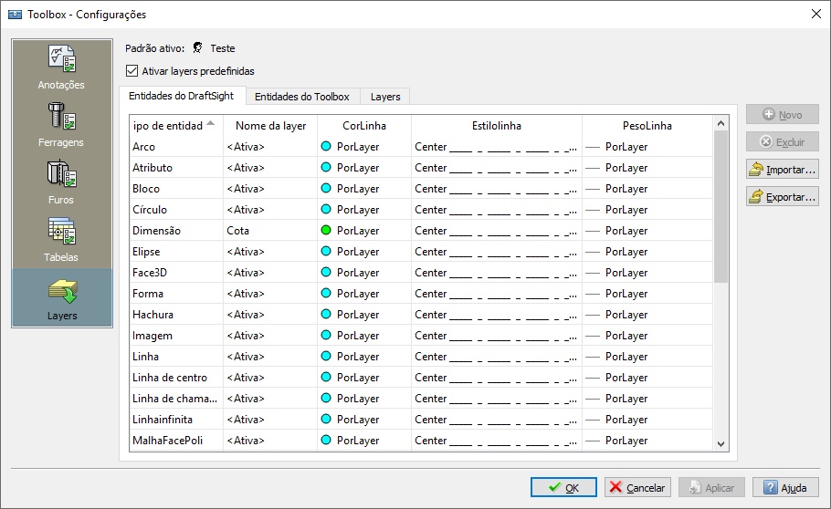

When using the new command CENTERLINE two strange things happen. First, the drawn line LineStyle is CENTER not ByLayer (as expected) nor Dashdot. Second, the definition of my custom Layer Centro changes to Continuous Solid Line.

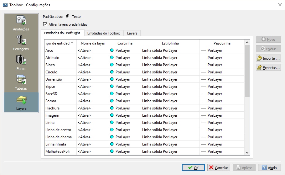

Another related issue. When setting the Application Language to Portuguese, whatever change I make to the Toolbox Settings, Layers page, results on the LineStyles of ALL entities set to CENTER . Everything I draw with Enable predefined layering active is then drawn with CENTER LineStyle.
