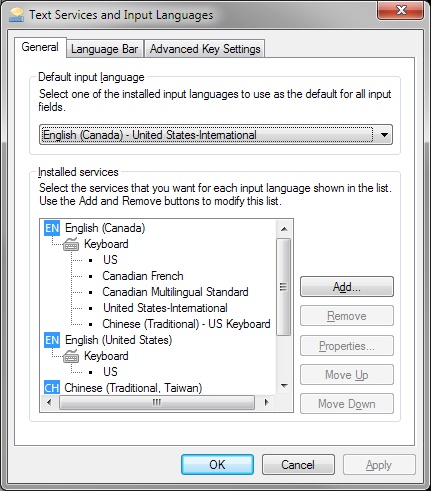

My Default input language is English (Canada).

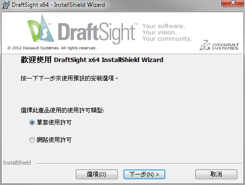

However, when installing DraftSight the language alarmingly always starts up in Chinese!

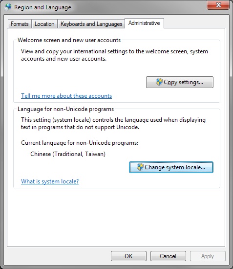

I eventualy figured out that it has something to do with my system locale being set to Chinese (Traditional, Taiwan).
To install DraftSight in English, I have to first change my system locale to something English, reboot, then install DraftSight, then re-set my system locale back to Chinese, then reboot again.  (System locale won't update without rebooting.)
Besides being an mere annoyance with the added reboots everytime there is an update to DraftSight, it's a genuinely serious problem because any user trying to exit from the installation dialogue has to navigate 4 dialogue boxes blindly in an unfamilar language in order to exit the installation process. It seems equally possible to mess up an installation as it is to cleanly exit. Fortunately, I'm usually able to hit Esc during the first dialogue box. But if I miss it, then trying to exit from the second dialogue box is a crap shoot.

But with the Chinese installation dialogue boxes in DraftSight, there is no way to copy the text to run through a translator.
