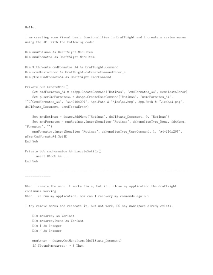

How to recovery my user commands for custom menus ?
Please see the document attached for format reasons
Thank you for your attention
