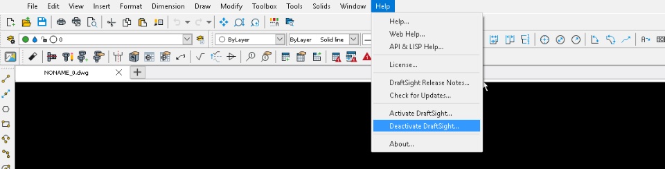

1. Open DraftSight on the machine that needs replacement.
2. Go to Help/ Deactivate DraftSight…
-> The Product Activation dialog opens. Follow the instructions on screen
