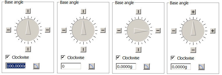

Dear friends,
As a (retired + Dutch) surveyor  I have set my Zero to North, my units to Grads and the direction Clockwise.
Don't ask me how I managed that, but it's functioning since I installed and configured 'my' DraftSight.
 About a moth ago I started a simple Dutch explanation on DraftSight ( http://www.draftsight.jouwweb.nl ) hoping to inspire young potential colleagues.
On configuring via Format/Unit System... I would like to explain the above mentioned config. but I met with the following problem.
I am not able to set the needle at zero together with the value below.  Changing this100 manualy to 0 the needle jumps to the positive abscis (9 o'clock).
To my opinion a proper 'picture' should be the one at the right whit the '+' and '-' signs just as a possible extra.
