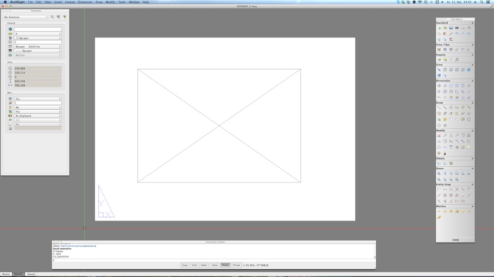

- Start a new drawing from the standardiso template. You now get a new drawing with an A3 sheet.

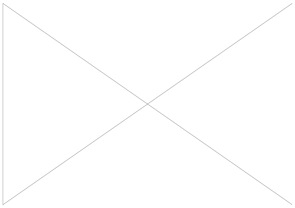

- Create a rectangle on the sheet that is 2-3 inches or 50-75 mm smaller than the sheet like this:
- Export to PDF. What you get is a PDF with the rectangle sides all the way out to the edges of the sheet. It seems Draftsight does not take the paper size you choose into account at all. It automatically resizes the pdf output to fit everything inside the printable area. This is the result:
