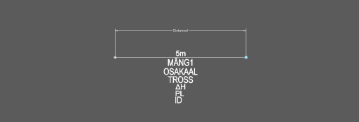

I have been using AutoCAD for few years and now thinking about starting to use draftisight. I have a block from autocad that I just can not seem to get to work. It is a polar stretchable line with attributes in the middle. I want these attributes to stay in the middle of the line when I am stretching and rotating the line. For that in AutoCAD I used 2 polar stretches. One for the line and other for the attributes. The attributes polar stretch has a distance multiplier of 0.5.
The block is working fine in AutoCAD, but in draftsight the distance multiplier is also multipling the rotation angle of the block. So as I am rotating the block, the attributes do not rotate as fast.´and the block is not working.
I will also add a block.
does somebody know a workaround around this? Is there a way to just have the distance multiplier multiplying the distance and not the rotation..?
