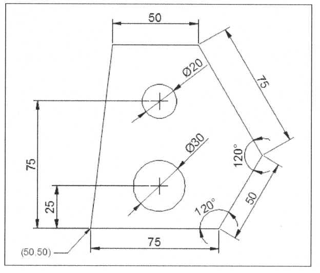

Hi, me again- trying to re-learn DraftSight after a 6-year hiatus. I am trying to draw this exercise using relative distance and relative angle (forget the circles):
When I enter the second point I get this (Command line image):
Where it says “Point or option keyword required” what is it looking for? Please note that the form “@75<@60” is shown as the second example in the Help table below for Polar (2D).
However, in the text below the table under “To specify relative polar coordinates and relative angle,” Step 3 says “Specify the second point with respect to the previous segment using the 2D format, "@relative_distance TAB @relative_angle", for example @7.5 TAB @45.” What I the world do they mean by “TAB”? I tried every which way to use it but it never worked for me.
