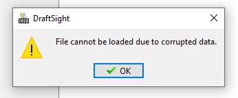

Encountered an issue this morning in which my layer style wasn't able to be loaded due to being corrupted. I did some cursory diagnosis, and found that any default colors on the style will save properly, and at least 1 custom color will also save and export properly.
In order to check for issues with just this particular file, I recreated the layer style manually on a brand new blank drawing, and re-exported it. I opened another new file and imported the freshly exported layer style, and was told the style was corrupted. so something is up with Draftsight's ability to read layer styles suddenly, wondering if anyone else has encountered this issue and how it might be resolved. I opened the Layer files with Notepad++ and compared with functional files, and they all look just fine. I also didn't recently update or anything, it's been working for weeks on DS2020 with no issue before this morning.
Edit 1: Restarted my workstation, didn't repair the issue.
Edit 2: Through experimentation, i found a temporary workaround, I made a master file with my with all my layer styles drawn out in a row of lines on a blank file. I copied and pasted the drawing to another file, and opened the layer states manager. Then I added a layer state, which included all my layer styles.
I was then able to import my layer styles again on that file, but only if they matched the layer names. if a layer on the old file matched the imported layer's name, it would overwrite and update the colors of the original layers, as I wanted.
