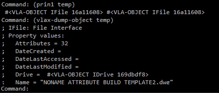

The code below allows the user to select a file and returns the file's last modified date. Once the code has been loaded into DraftSight, type "TEST" into the command line to run the script. For me, the code throws an error whenever it tries to execute the "(vlax-get fob 'datelastmodified)" command.
Command: TEST
Test :
 Error: Invalid parameter.

(defun LM:filelastmodified (fnm / fob fso rtn)
    (setq fnm (findfile fnm))
    (setq fso (vlax-get-or-create-object "scripting.filesystemobject"))
    (if (and fnm fso)(progn
        (setq fob (vlax-invoke-method fso 'getfile fnm))
        (if fob (progn
            (setq temp fob);<-- Added in Update<br />            (princ "\\nTest : ")(prin1 (vlax-get fob 'datelastmodified))(terpri);<-- Error: (vlax-get) 'datelastmodified and 'ModifyDate have failed
            (setq  rtn (+ 2415019 (vlax-get fob 'datelastmodified)))
            (vlax-release-object fob)
        ));if<-progn
        (vlax-release-object fso)
    ));if<-progn
    rtn
);LM:filelastmodified
Update:
By adding "temp" to the code and doing an object dump, the property can be found, but the value isn't being copied with it. Hopefully, this helps.
