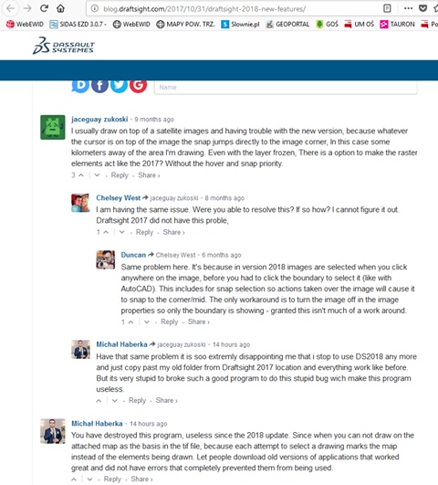

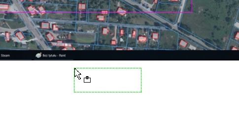

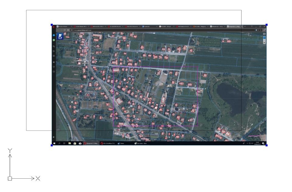

I start to have big problems with my Draftsight after updating. I make civilenginering draws on atachet tif maps. After change my system and instal newest draftsight i cant select anything on my drawings. It always select the map and try to replace it to othere place. Before update map always stay at place and when i try to select something wich is on this map it was selected, now it cant be done. It wasnt problem in oldest version of DS.
