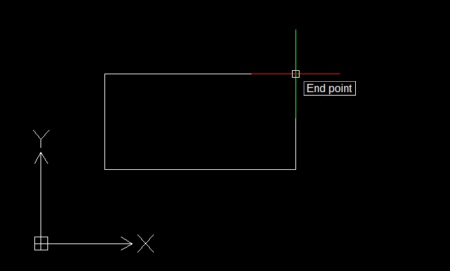

DraftSight v1.5r2:
- pick the first point (left up corner of rectangle)
- pick the second point (right up corner). Cursor stays here, snap information is displayed (End point in this example). After mouse click exact distance is acquired, 50mm in this example.

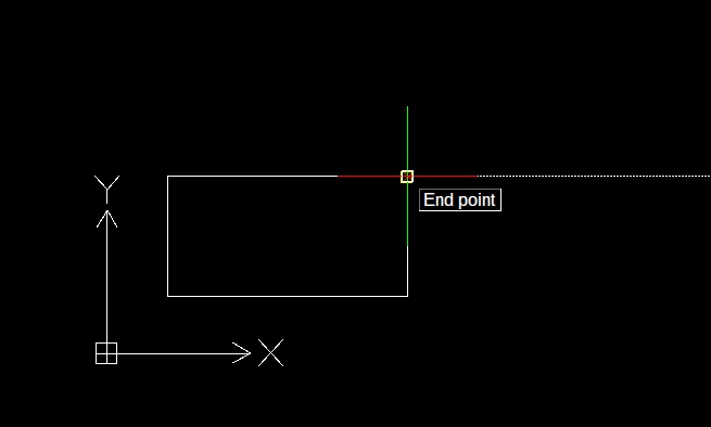

Draftsight 2015:
- pick the second point (right up corner). It looks like cursor stays here, snap information is displayed (End point in this example). But after mouse click incorrect distance is acquired, 50,028mm in this example.
In version 2015 projection line is displayed and it looks like this override/collide with entity snap during acquiring distance.
