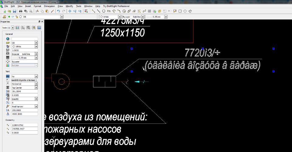

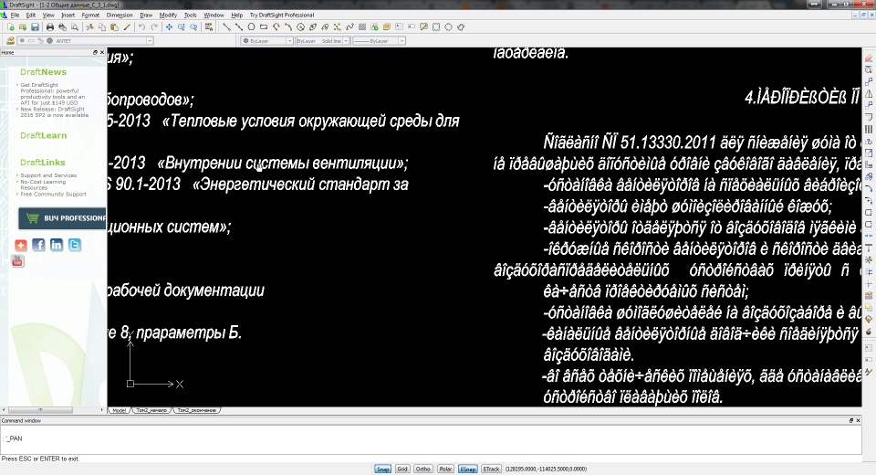

I have a file with Russian cyrilic text in the drawing. The simple text is displayed correctly, but the "note" type is messed up. I have no experience with creating and managing notes.
The content of the non-working note is:
\\pxqc;{\\fArial Narrow|b0|i1|c162|p34;7720\\fArial Narrow|b0|i1|c204|p34;ì3/÷(óäàëåíèå âîçäóõà â ãàðàæ) }
What can I do with it? In Autocad it works without problem.
See the attached image, the left side is correct, the right side is mess.
Thank you!
