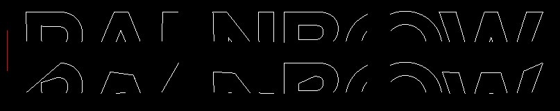

There is a bug in Explode Spline (_explodex). I have found multiple splines that error when attempting to convert to a polyline. The only resolution that works with these splines is anything less than 5, which is problematic for my CNC operator. Please fix this. I've attached an image. The upper section is the original, and the lower section is a copy that I've applied explodex to with a resolution of 50. To give a sense of scale, the red line is 1000mm. Is there way to upload this DWG/DXF?
I find this tends to happen with what is originally imported as a closed loop spline.
