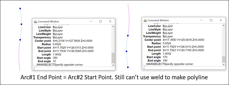

Dear Admin,
I recently update from Draftsight 2019 to 2023 SP0 Version and I have problem that sometime I have to "explode" arc polyline into multiple arc lines, but I can't "weld" them to make it polyline again. I have to move end point of Arc#1(In the picture) to somewhere and move back to same position to make it able to "weld".
