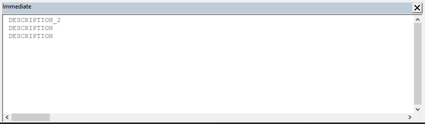

Debug.Print dsAttributes.Value 'Bad Results

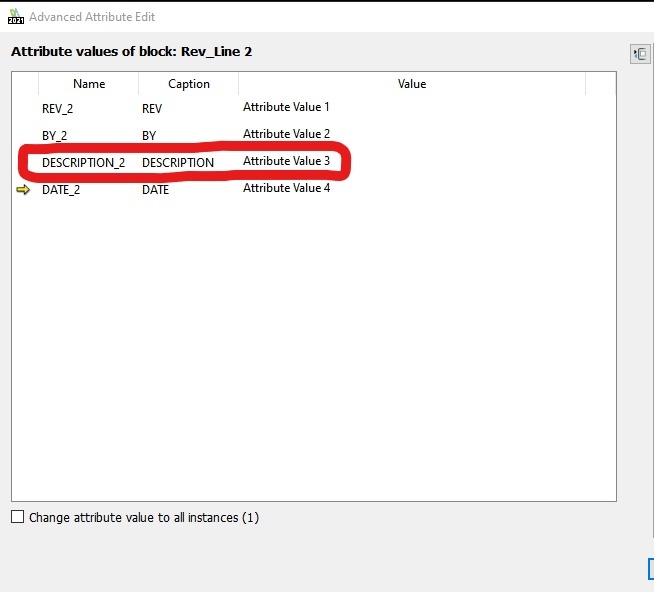

The images attached are of what I expected versus actuality.
