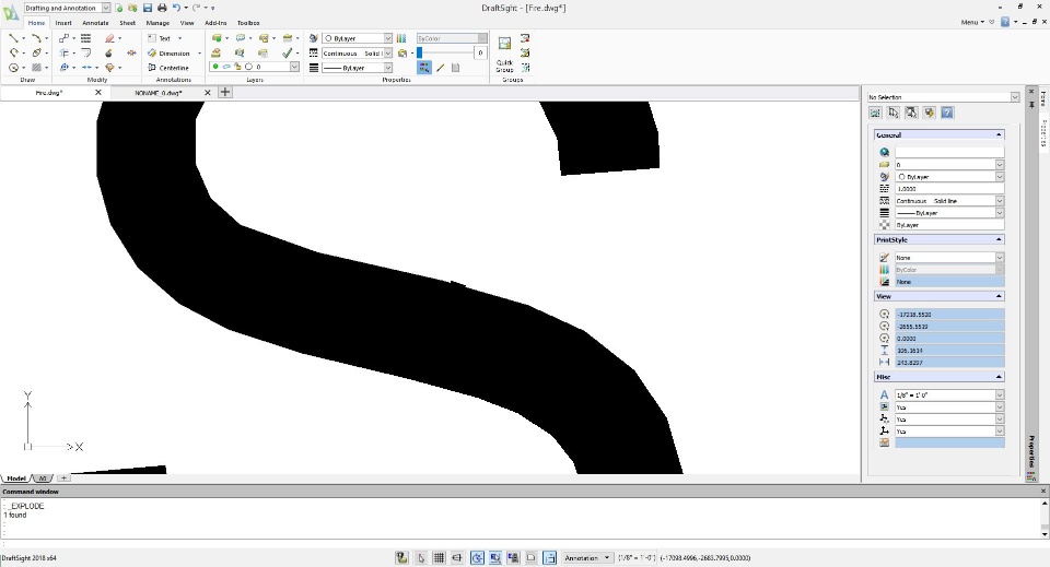

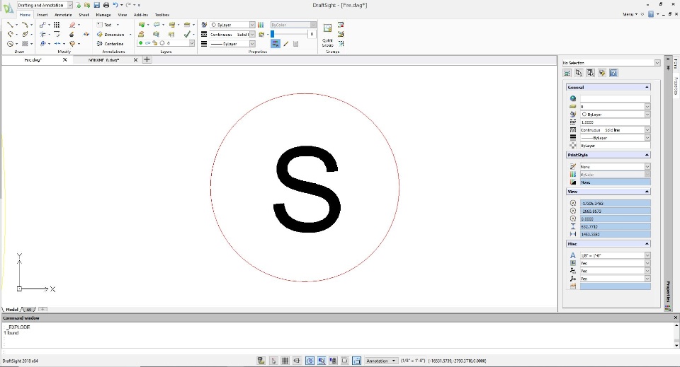

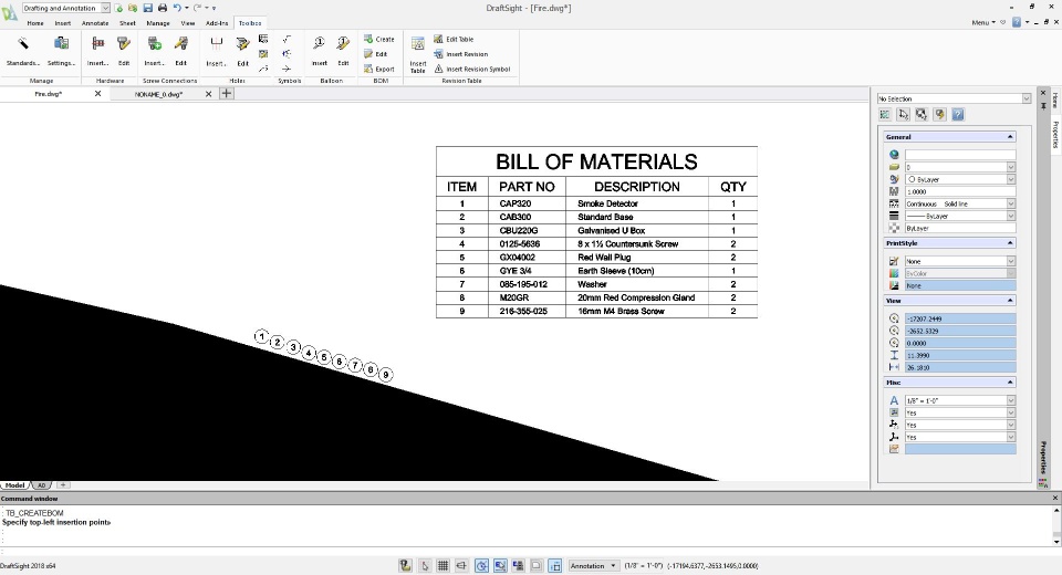

I design fire alarm systems and am wanting to use the BOM Table function.
I have created a block for a standard smoke detector and as you can see from the attachments (ive attached x3 here so you can see the zoom in) I have 9 'balloons' making up this one device.
so I now have one smoke detector block and 9 separate balloons.
but I need to multiply this and make it idiot proof so rather than having to select the block and the 9 balloons separately every time I want to add a detector is there a way I can group the block and the balloons together so they in turn form one block?
I have used quick group which works, however every time I copy and paste it, it ungroups itself after I paste it.
and when I select the existing block and balloons to make a new block, when I go to create the BOM table it doesn't see any information to create a table.
so question is - is there a way to make my block and separate balloons one so I can just copy and paste them around the drawing?
