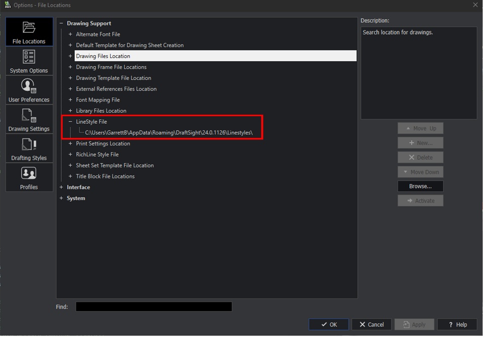

Hello, is there a way to call the "LineStyle File" string in AutoLisp? I'm looking into creating my own layer with AutoLisp, but if a particular line style isn't already loaded, then I need to reference both the file path as well as the file name. I see the path I want to use in the OPTIONS menu, but I don't know how to read it in AutoLisp.
